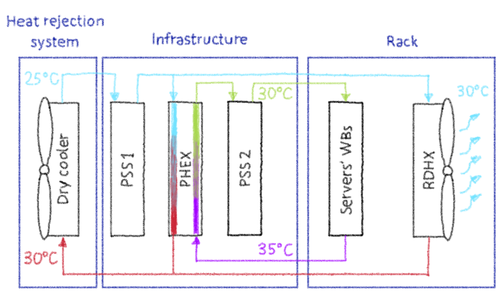

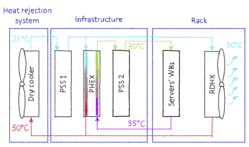

In a traditional OVHcloud data centre with a Delta T=5K setting, water temperature is to be maintained at 25°C providing inlet air temperature at 30°C and inlet water temperature of the waterblock at 35°C. As shown in the figure below, two circuits in parallel are connected to the rack.
Delta T=5K
Through constant development, we improved the cooling design of our rear door heat exchanger (RDHX) to increase the inlet water temperature and reduce pinch between cold air and cold water: this way, the data center inlet water temperature is now set at 27°C against 25°C previously.

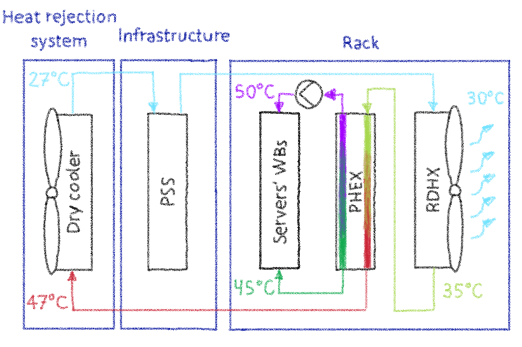

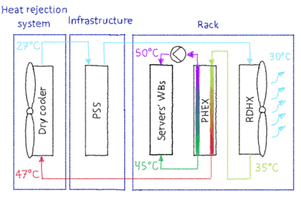

Building up on the notable improvements we discussed, we were also able to setup a serial circuitry with PHEX and RDHX on the rack level in order to achieve a complete Delta T=20K environment as shown in the figure.
Delta T=20K explained
With water temperature maintained at 27°C, the inlet air temperature of the data centre remains at 30°C and inlet water temperature at 45°C for the waterblock. The data centre water outlet temperature is set at 47°C. On a sidenote, our robust design gives us confidence in the ability to operate with a higher temperature profile, still in a Delta T=20K setting, like 32-52°C.

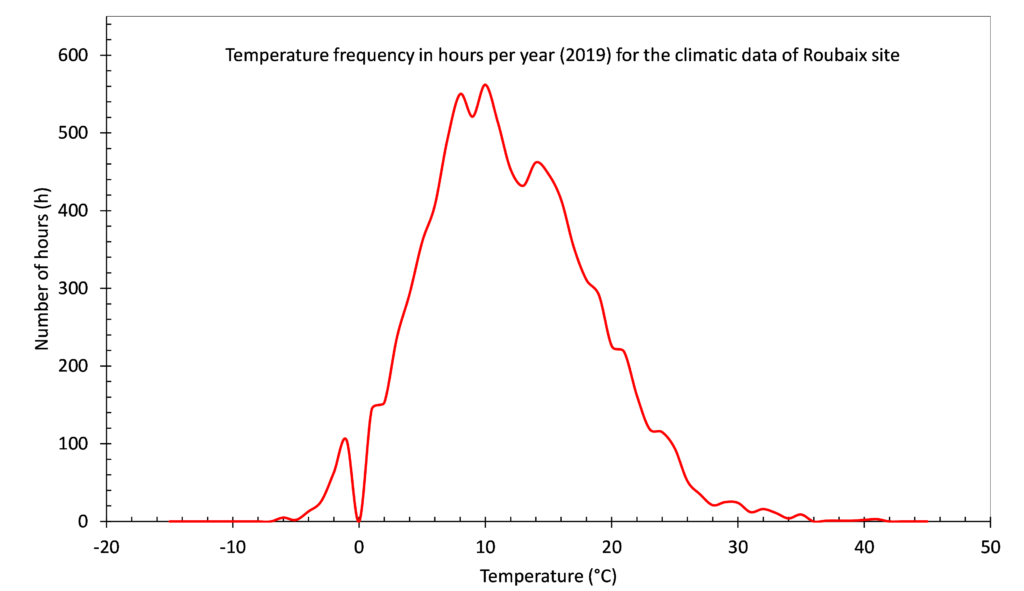

We elected for the following methodology. We collected and analyzed the weather data for the past 40 years, including temperature and relative humidity with a record every 30 minutes. For the Roubaix site for example, the warmest year happened to be 2019. Figure below shows the temperature frequency in hours extracted from climatic data recorded at Roubaix in 2019. The key hours are between 5 and 20 °C.

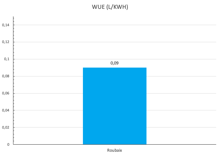

Based on our working principle, we can deduct the WUE in every country where we have a data centre. For your reference, in this scientific paper we estimated the theoretical WUE for some of our locations that offer the best possible representation of various climatic conditions: Roubaix (France), Mumbai (India), Singapore, VintHill (USA). For accuracy purposes we’re sharing below the estimated WUE for Roubaix:
This theoretical result is impressive. Yet, it’s important to have a better sense of what WUE can represent: we estimate that in an IFC with a Delta T=20K setting, 381 m3 of water are enough to cool a 600 kW DC versus 964 m3 in an IFC with Delta T=5K setting.
