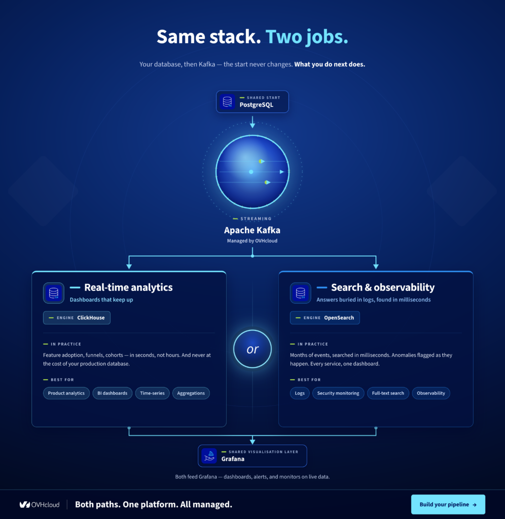

Two paths through the same architecture
The topology is consistent regardless of your use case: source database, Kafka as the streaming backbone, one or both analytics engines, and Grafana on top. How you build it depends on what your team needs first.
Same stack. Two jobs
The real-time analytics path
PostgreSQL + Kafka + ClickHouse + Grafana is the right starting point when the primary need is fast, flexible querying. Product analytics, business intelligence, time-series reporting, funnel analysis, A/B test results in real time: these all call for ClickHouse. It ingests directly from Kafka topics, materialises views that dashboards query in milliseconds, and handles aggregations over hundreds of millions of rows without breaking a sweat. The SaaS company that needs to see feature adoption as it happens, the fintech tracking transaction volumes by the minute, the e-commerce platform running live inventory analytics – these all follow this same path.
The search and observability path
PostgreSQL + Kafka + OpenSearch + Grafana is the right starting point when the primary need is full-text search, log aggregation, or system-wide observability. OpenSearch indexes events as they arrive, enabling complex searches across months of structured and semi-structured data with sub-second response times. The security team correlating events across distributed services, the platform team centralising logs from dozens of microservices, the SRE team building alerts on top of live event streams – these all follow this path.
