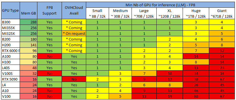

If we apply this formula to few standard LLM sizes / Contexts, we get the following:

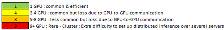

Now we'll apply this to the most common GPU you can find to get the minimum number of GPU you need :
Color Legend, considering that servers usually come with 4 or 8 GPU (16 GPU soon)

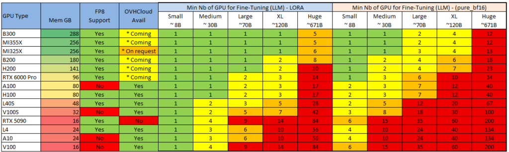

See also for 2 common Fine-tuning methods :

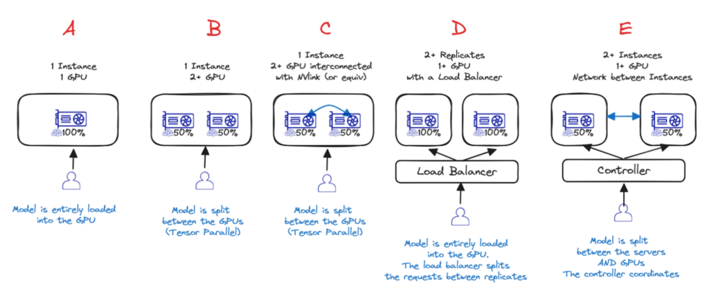

a) Different deployment options
Now that you know which GPU and server to choose, you also have several options for the architecture setup.
Option A - Single GPU
If the model is small enough to fit into a single GPU, then it’s the best option !
Option B and C - Single instance, Multiple GPU (with or without interconnect)
If it’s too big for a single GPU, then the best option is a single server with multiple GPUs. Either with (Option C) or without Nvlink (Option B). In these two cases the weights of the models are spread over the different GPUs but there is a cost : you will not have 2x the performance of 1 GPU !
Option D - Single instance, Multiple replicates with Loadbalancing
If the model fits on 1 server (1+ GPU) but the performance is not enough, or you need to scale dynamically based on the current needs, then your best option is to use multiple replicates and add a loadbalancer (Option D) – This what AI Deploy provides off the shelf.
Option E - Distributed inference over several servers
If the model is too large to even fit on a single server, then you must distribute the inference over several servers (Option E). By far the most complex (you need to setup the network and software for clustering) and the highest loss in performance (due to server to server network bottlenecks, on top of GPU to GPU).
