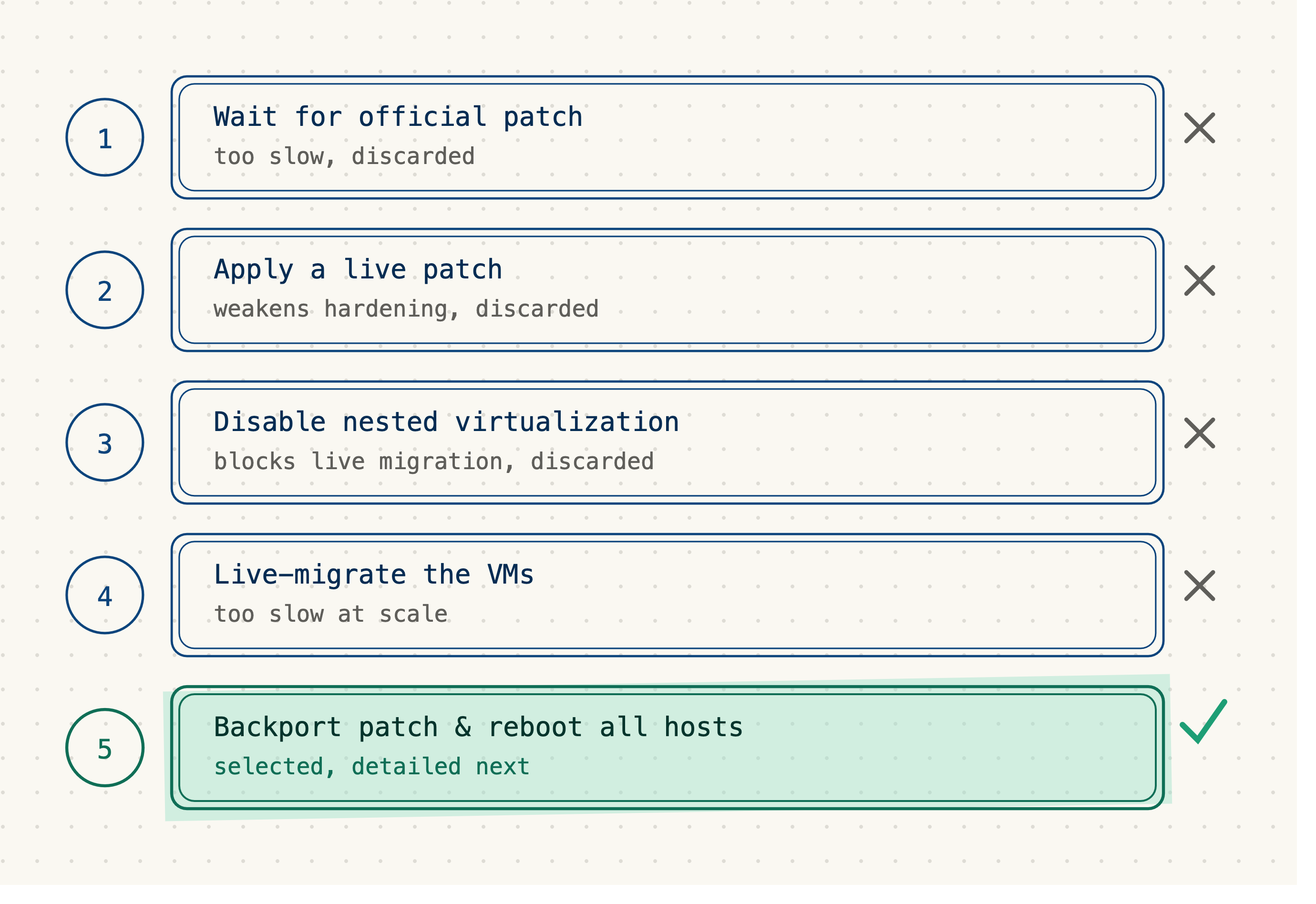

Options for mitigating risk
OVHcloud mitigation
1. Wait for official patched kernels
This option would leave us dependent on a third-party timeframe, leaving us in an at-risk status for an uncontrolled period of time. We therefore quickly ruled this option out.
2. Live patch
Applying a live patch requires authorising this type of operation in the kernel configuration, which allows (by design) ad-hoc modification of its behaviour, but results in a reduction in its hardening level, limiting its compromise detection capabilities. Furthermore, the live patch is a sensitive procedure, which could lead to an unstable fleet status. It is an option that buys time while waiting for a long-term solution. We decided not to make this compromise, as it would have sharply increased the risk if an exploit for taking control of the host was published.
3. Mitigation by disabling nested virtualisation
Disabling nested virtualisation on the hosts would make the exploit inoperative. We do not have visibility into how our customers use this feature, so it is not possible to determine the impact on customer services, and this feature is necessary to maintain the ability to live migrate an instance from one physical host to another. As a result, we quickly ruled this out.
4. Live migrate
This involves organising a live migration of virtual machines, from vulnerable hosts to empty hosts that have been patched in the meantime. This option is very satisfactory in terms of service continuity because the migration is done without any impact on the virtual machines, with the exception of reduced performance during the migration. This option takes a long time due to the host-to-host virtual machine copy, meaning that it is not realistically usable due to the scale of the fleet and the desire to protect our customers within a few days rather than several months. We decided to keep this option for certain critical virtual machines only, as each live migration causes a significant delay in the execution of batches.
5. Backport the patch on our kernels and reboot all hosts
We ultimately chose this option, which will be detailed further in this article.
