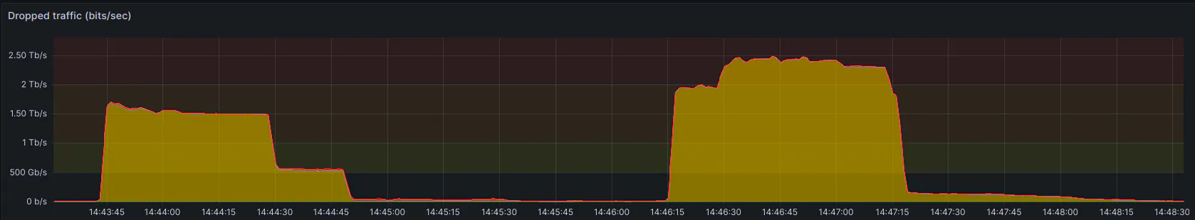

Packet rate attacks started to seriously get some attention at OVHcloud two years ago, after we were hit — but successfully mitigated — by a gigantic UDP flood for more than 6 hours, reaching ~700 Mpps in average for ~4 hours.
Figure 2: this particular attack highlighted, at the time, the significant increase of capacity by botnets to generate ludicrous packet rate while being able to sustain that rate for a long period of time.

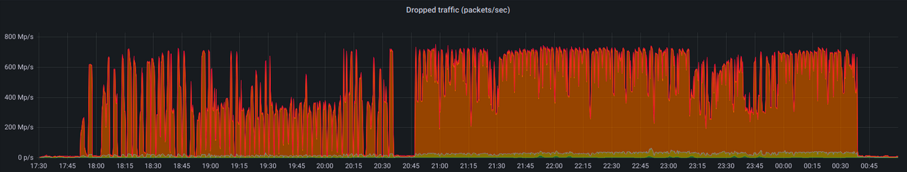

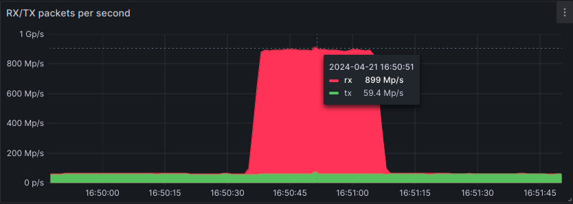

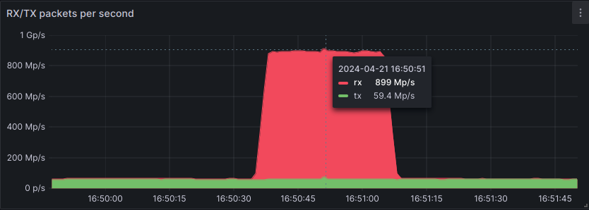

In the past 18 months, and especially in the past 6 months, we noticed a sharp increase of DDoS attacks leveraging packet rates greater than 100 Mpps. We went from mitigating few of them each week, to tens or even hundreds per week. Our infrastructures had to mitigate several 500+ Mpps attacks at the beginning of 2024, including one peaking at 620 Mpps. In April 2024, we even mitigated a record-breaking DDoS attack reaching ~840 Mpps, just above the previous record reported by Akamai.
Figure 3: record-breacking DDoS attack mitigated by OVHcloud reaching 840 Mpps
This attack was 99% of TCP ACK, originating from approximately 5,000 source IPs. Interestingly, the 1% remainder was a DNS reflection attack, leveraging ~15,000 DNS servers to amplify the traffic, which is not really efficient when trying to achieve high packet rate attacks.
While the attack was distributed worldwide, 2/3 of total packets entered from only 4 PoPs, all located in the US with 3 of them being on the west coast. This highlights the capability of the adversary to send a huge packet rate through only few peerings, which can prove very problematic. Generally, anti-DDoS response teams — not only at OVHcloud — assumes that it's really hard to send massive DDoS from only few geographical locations. Based on this assumption, our infrastructures are scaled horizontally, spread worldwide, and they absorb the load more easily. However, the traffic distribution of the 840 Mpps attack has strongly questioned this assumption. While we do have the local capacity to mitigate this attack, we will consider to adjust the general scaling and distribution model of our anti-DDoS infrastructures to ensure to cope with future (and probably bigger) attacks, just as we do today.

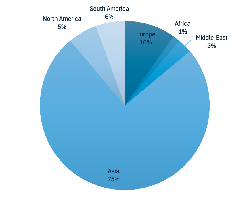

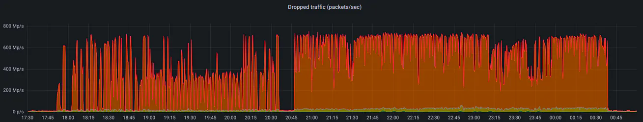

During our analysis campaign, manually dissecting almost a hundred packet rate attacks ranging from 100 up to 500 Mpps, we noticed that many attacks originated from not-that-many sources, which are sending a large proportion of the total traffic. We established a list of well-known offending IPs capable of generating at least 1 Mpps each, and decided to dig further.

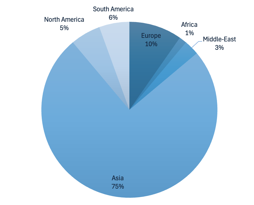

We analyzed the top 70 IPs issuing the highest packet rates, up to 14.8 Mpps per IP. These IPs belongs mostly to Autonomous Systems (AS) in Asia, but Europe, Middle-East, North American and South America are also represented. The ASs identified seem to belong mostly to business ISPs or Cloud Connectivity providers.
Figure 4: distribution by locations of the AS of the top 70 IPs issuing the highest packet rates.

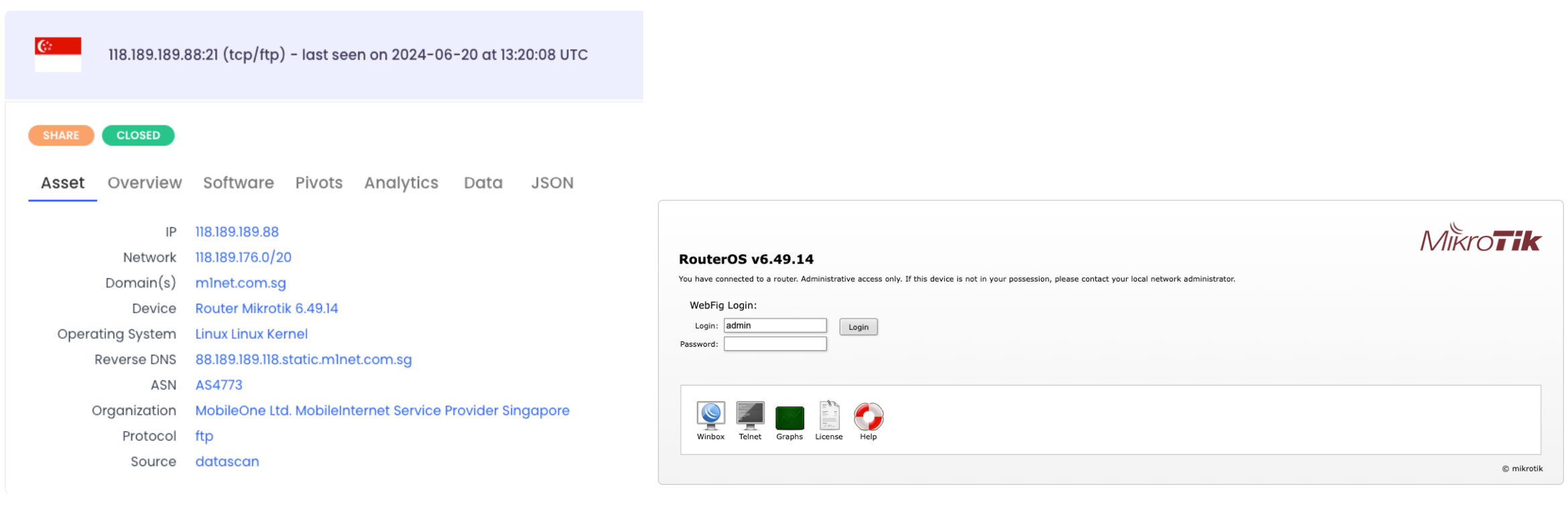

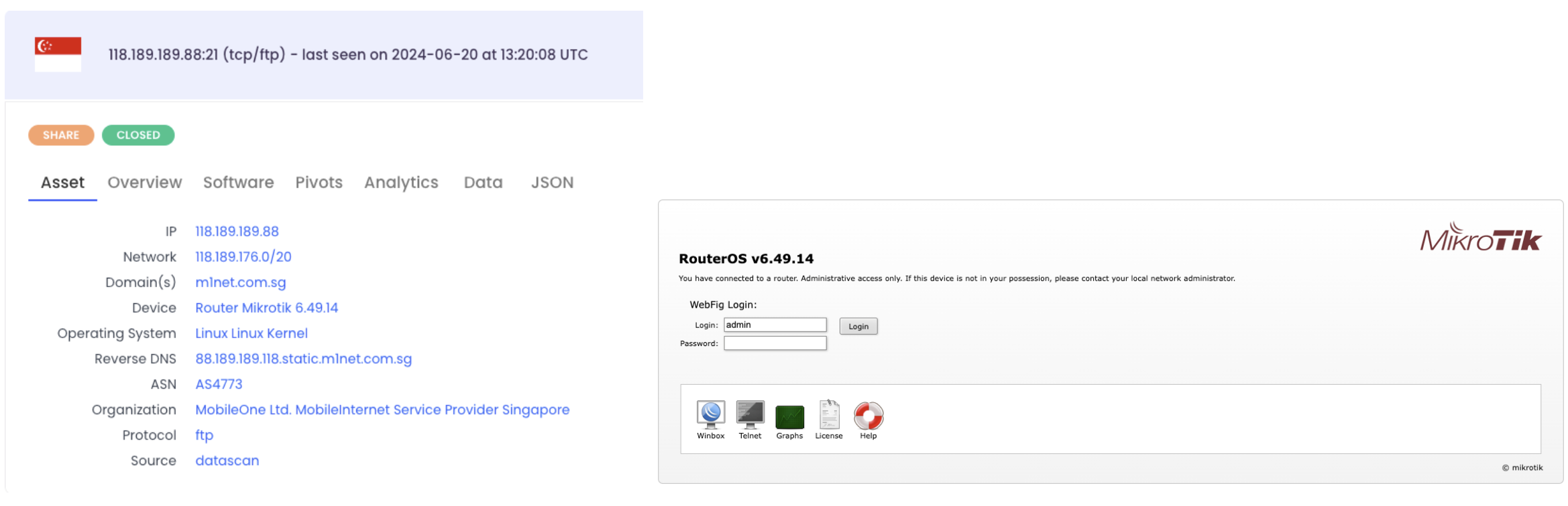

To understand what kind of devices were involved in these DDoS, we used Onyphe to determine if these IPs were known. Indeed, a great part of these IPs are known as MikroTik Routers and are exposing on the Internet — at least — the configuration webpage.
At this point, it remains possible this traffic is generated either by servers located behind a router configured with NAT, using spoofed IP, or leveraging some kind of weird TCP reflection. However, we quickly dismissed these hypotheses due to the improbability of encountering such a significant number of identified MikroTik routers, given that MikroTik does not hold a proportionately large market share. In addition, exposing an administration interface reflects poor management practices. It increases the device's attack surface and can facilitate its compromise by an attacker. Moreover, RouterOS — MikroTik's operating system — has suffered from several critical CVE over the past years. Even if a patch has been released, these devices may have not been patched so far.
Since the HTTP interface is open on most of the devices, it is possible to use it to recover the version of RouterOS running on said devices. Half of them are running a RouterOS version prior to 6.49.8 – released on May, 23rd. 2023 – and the other half is running a later version. For instance, devices running RouterOS 6.49.14 – released on Aprit, 4th. 2024 - have been identified.
Figure 5: example of MikroTik device involved in high packet rate attacks identified by OVHcloud teams.
We have been surprised to discover devices with a recent firmware being potentially compromised though. As far as we know, no vulnerability affecting RouterOS 6.49.14 and later versions have been publicly published so far. A possible explanation would be these devices may have been patched after their compromission.

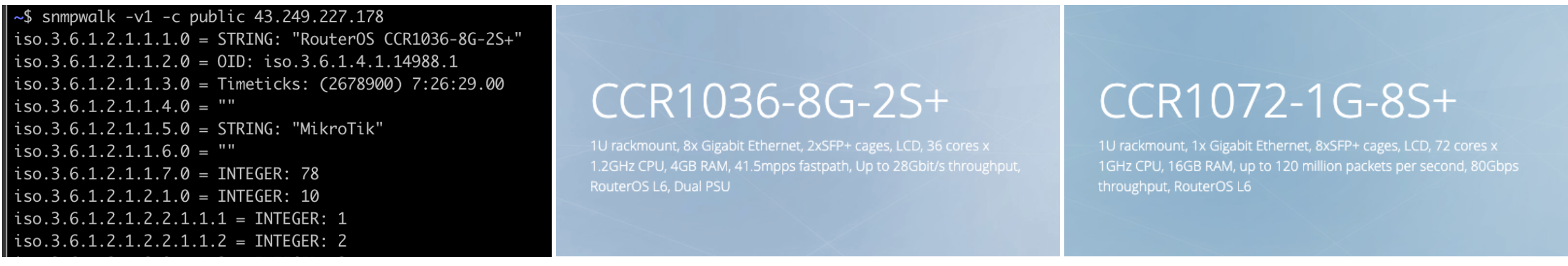

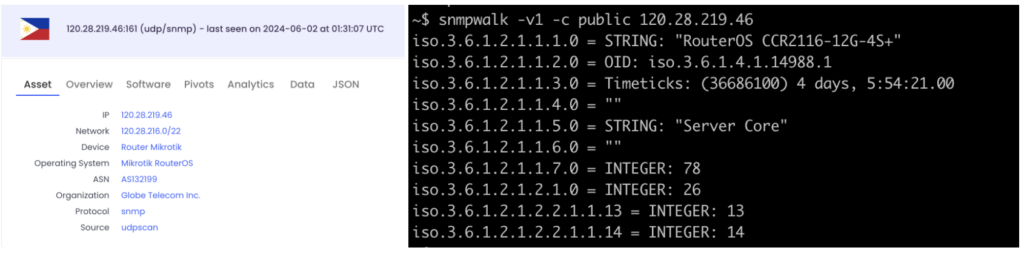

Using SNMP on devices exposing it, we have been able to determine what kind of devices were capable to issue such a high packet rate. As expected these are not residential routers, but rather core network devices.
Figure 6: identification of the Cloud Core Router devices
The results highlight the MikroTik CCR series, which stands for Cloud Core Router. Indeed, SNMP returned several CCR1036-8G-2S+ and CCR1072-1G-8S+.

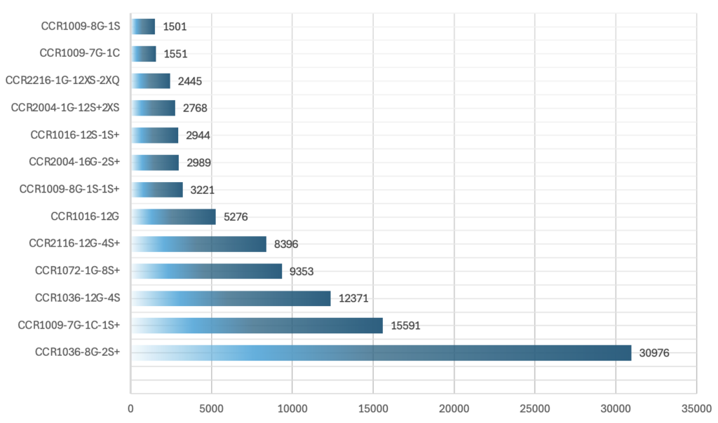

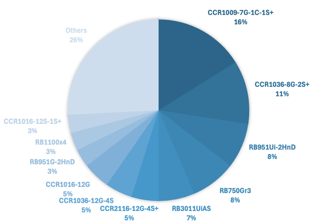

In order to have an overview of how many devices could be compromised and used in such massive packet rate DDoS attacks, we used Onyphe once again to search for CCR devices wide open on the Internet. 99,382 CCR devices were identified.
Figure 7: distribution of the device models found open on the Internet according to Onyphe.
We can see that both device models involved in the packet rate attacks observed by our teams – CCR1036-8G-2S+ and CCR1072-1G-8S+ – represents at least 40,000 devices open on the Internet. The CCR1036-8G-2S+ is the most found device on the Internet with 30,976 occurrences, and the CR1072-1G-8S+ is the 4th most found device with 9,353 occurrences. Since we still don't know what kind of vulnerability has been leveraged to compromise these device models, we can't say yet whether other CCR models could be compromised as well or not. Nonetheless, exposing the administration panel on the Internet remains a big risk for the security of the device though.

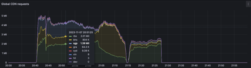

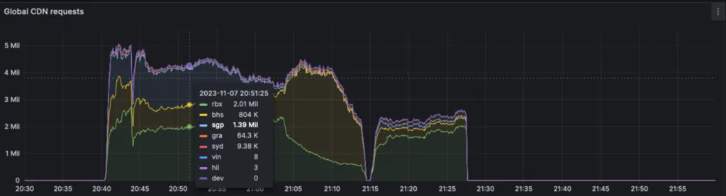

Thanks to internal data sharing and discussions, we were reminded about a L7 attack which occurred during November 2023. At the time, MikroTik routers were identified, but it did not ring bells. This attack reached 1.2 millions requests per second using HTTPS and involved roughly 3,000 source IPs. Considering our recent findings, we decided to take another look at it.
Figure 8: layer 7 DDoS attack involving MikroTik devices recorded in November 2023.
