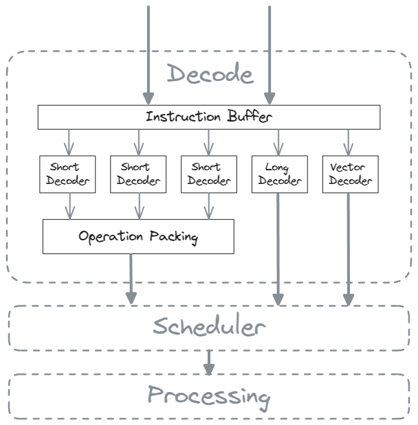

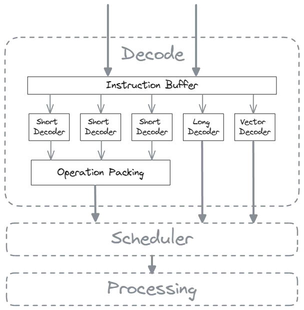

Instructions specific to CPU architecture (or macro-instructions) are complex and must be broken down into sequences of simple instructions.

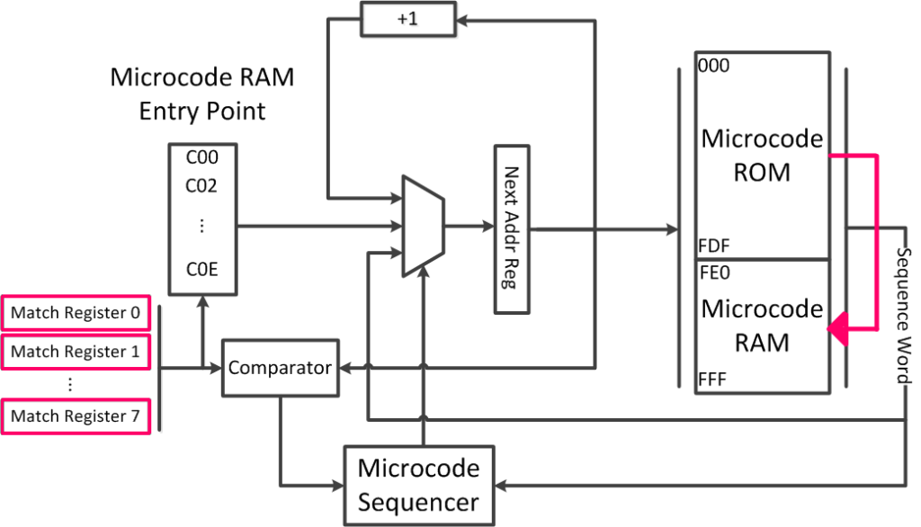

Microcode uses 2 types of storage:
- Microcode ROM: for storing the program
- Microcode RAM: for storing the microcode update

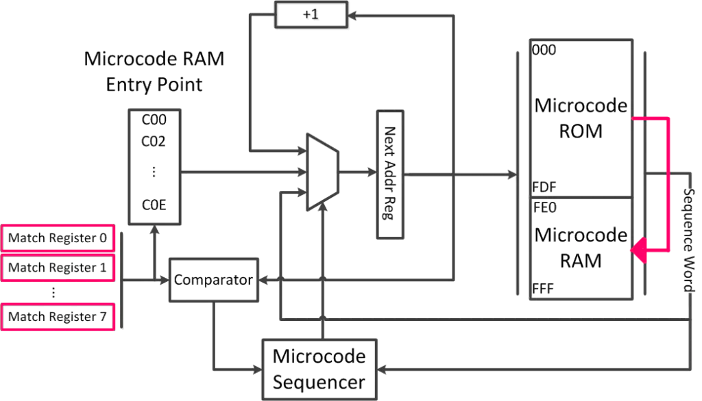

Match registers are used to provide breakpoints in the microcode ROM
When a particular address is reached, it’s rerouted to the microcode RAM containing the update.
Since microcode patches are stored in a low-latency volatile on-chip RAM, it’s fairly limited in size and not persistent. Each time the system boots, it needs to:
- be in kernel mode (or supervisor mode)
- load microcode update into RAM
- write the update’s virtual address to the Microcode Specific Register (MSR)
By design, microcode patches add extra condition checks, which slows down CPU performance. Additionally, patch application isn’t always successful, and in some cases, only provides a partial fix.

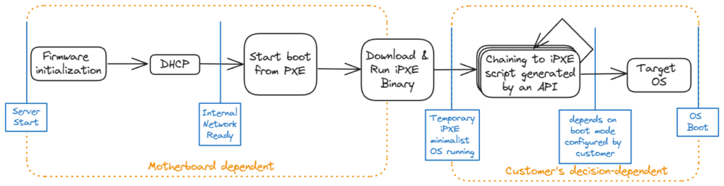

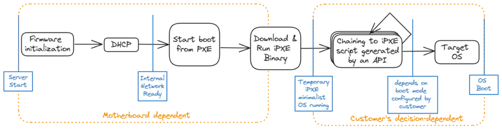

OVHcloud boot process
As previously mentioned, the wide range of hardware motherboards makes it impossible to automate the boot mode switch from BIOS/UEFI. This is why OVHcloud uses a temporary, minimalist, in-memory OS for the boot process. One major advantage of this open-source boot firmware is its powerful scripting, which extends the capabilities of traditional Preboot Execution Environment (PXE) without the need for BIOS/UEFI reflashing. The boot process unfolds in the following steps:
Depending on whether the customer chooses to boot from disk, a rescue environment, or a custom iPXE script, the corresponding iPXE script will run.
If a custom iPXE script isn’t chosen, the system downloads the latest validated AMD or Intel (CPU-specific) microcode bundle and signature from OVHcloud. Once the signature is validated, the microcode patches are distributed across all the CPU’s cores. The system then boots from a local disk or a remote image.
If the customer decides to boot using an iPXE script, the API will generate the iPXE script as per the customer’s specifications, with no changes made. This means that without a custom iPXE script specifying otherwise, customers won’t receive microcode updates.
