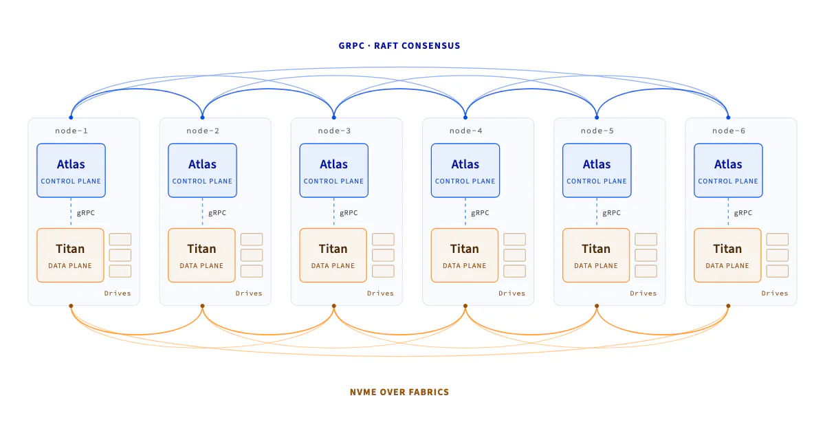

GRPC RAFT CONSENSUS
Anatomy of a cluster
A typical Exten cluster is made of six servers. These servers are close to each other so that the latency between them is low, but not too close to limit the chances of multiple servers failing together. Each server has dozens of NVMe drives to store user data.
Exten is built around the NVMe protocol. It uses NVMe drives, but it also uses the NVMe over Fabric protocol to expose user volumes and to communicate between hosts. Volumes are virtual drives that customers can attach to their VMs. This protocol uses the same commands as NVMe drives, but over a network link (TCP or RDMA), and it's designed for high performance and low latency.
An advantage of NVMe over Fabric is that the Linux kernel supports it natively. Connecting an Exten volume to a Linux host is as simple as running an nvme connect command with the right parameters: the volume then appears just like any other local NVMe drive. As a Public Cloud customer, you don't see any of this — the volume is just attached to your instance, exactly like with Ceph.
Exten is split into a data plane written in C++ and a control plane written in Go. Both communicate through gRPC. The data plane receives IO through NVMe over Fabric and routes it to the NVMe drives. The control plane provides an API to create and delete volumes and to manage the cluster.
How to keep data safe
Keeping customer data safe is an Exten cluster's biggest responsibility, and we handle it at multiple levels.
On the control plane side, we use the well-known Raft Consensus Algorithm to guarantee the cluster's integrity in a fault-tolerant manner. It works by electing a leader and logging any new information — a new volume created, a drive enabled — in a log replicated across every host. If a host fails, the others keep working. The only limit is that a majority of hosts must stay up to avoid “split-brain” issues, so a six-node cluster can lose two hosts and keep working.
User data itself, or the actual IO done to the volumes, doesn’t go through Raft; that would be far too slow. Instead, we use another well-known algorithm: a Reed-Solomon code.
This error-correction code is conceptually simple. Take RS 4+2: we split data into four equal parts, then compute two new parts of the same size. If you can read any four of those six parts, you can recover the original data: the code lets you compute the two missing ones. That gives a ratio of 1.5 (data stored / data received), so we can lose two drives without losing any data. It's a highly efficient way to add redundancy. The naive alternative — usually called mirroring, which is just copying the whole data multiple times to different drives — would need three copies to survive losing two drives. With Reed-Solomon, we store half as much data for the same redundancy level.
Failing drives may be detected in two ways : either a read simply fails, or it returns with corrupted data — which is detected thanks to a checksum we add to each sector. When a drive fails, an automatic process recomputes the missing part and stores it on a healthy drive, lowering the risk of data loss.
