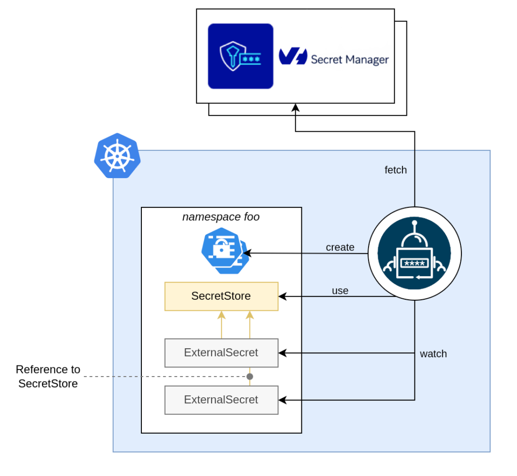

External Secrets Operator (ESO)
The External Secrets Operator (ESO), a CNCF sanbox project since 2022, is a Kubernetes operator that integrates external secret management systems.
The operator reads the information from an external APIs and automatically injects the values into a Kubernetes Secret. If the secret changes in the external API, the operator updates the secret in the Kubernetes cluster.
The ESO connects to an external Secret Manager, such as OVHcloud, Vault, AWS, or GCP, via a provider configured in a (Cluster)SecretStore. An ExternalSecret resource then specifies which secrets to retrieve. ESO fetches those values and creates a corresponding Kubernetes Secret within the cluster.
For more details, read the ESO official documentation.

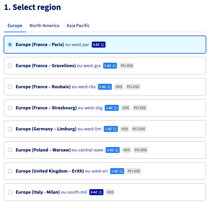

In the OVHcloud Control Panel (UI), go to ‘Secret Manager’ section and click on the Create a secret button.
Then in order to create a secret ‘prod/eu-west-par/dockerconfigjson’, in the Europe region (France – Paris) eu-west-par, choose this region:

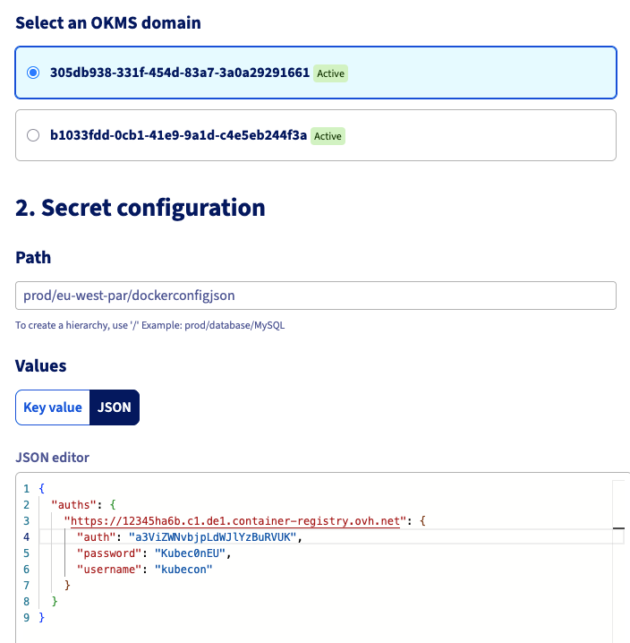

Then, choose the OKMS domain and create"prod/eu-west-par/dockerconfigjson" in the path and fill the content:
Finally, click on the Create button to finalise the creation of the new secret.
