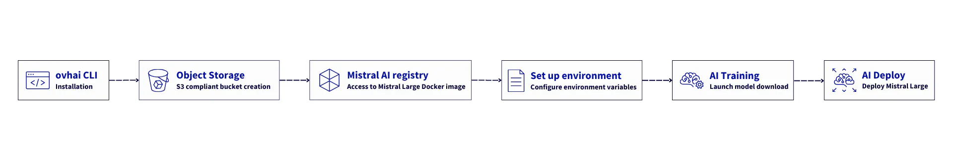

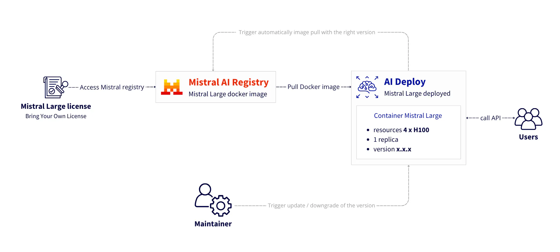

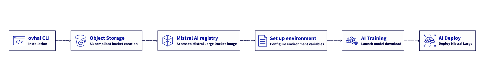

Overview of the Mistral Large deployment architecture
Here is how will be deployed Mistral Large 123B:
  1. Install the ovhai CLI
  2. Create a bucket for model storage
  3. Retrieve the license information from Mistral Console
  4. Configure and set up the environment
  5. Download the Mistral Large model weights
  6. Deploy the Mistral Large service
  7. Test it with simple request and advanced usage thanks to LangChain

Launch the Mistral Large service with AI Deploy by running the following command:
bash
ovhai app run --name DEPLOY_MISTRAL_LARGE_123B \
              --gpu 4 \
              --flavor h100-1-gpu \
              --default-http-port 5000 \
              --label mistral_large=api_key_reader \
              -e SERVED_MODEL=$SERVED_MODEL \
              -e RECIPES_VERSION=$RECIPES_VERSION \
              -e TP_SIZE=$TP_SIZE \
              --volume s3-mistral-large-model@<ALIAS>/:/opt/ml/model:RW \
              --volume standalone:/tmp:RW \
              --volume standalone:/workspace:RW \
              $DOCKER_IMAGE_INFERENCE_ENGINE
