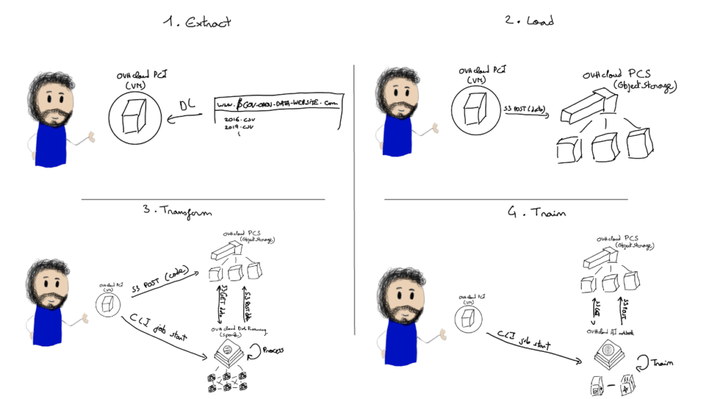

So what are we going to do to redo all of that without Dataiku's help?
  • For the extract phase, we are actually going to cheat a little bit and do things the exact same way: we will download the data directly from the website on a public cloud VM. Obviously this is not very scalable, but the extract phase is the most dependant on the source format: in that case, it's csv files from a webserver.
  • For the load phase, we are going to push these csv files to an object store - in that case OVHcloud PCS (Public Cloud Storage) - using the standard S3 CLI. An object store is ideal to store this kind of data because:It is infinitely scalable so no matter how much data I push, I won't have to handle storage provisioning etc…It works best with large objects (> 1MB. In our case, the csv files are around ~500MB)It works with standard APIs that most cloud providers provide and that you can also deploy on-premise if you wish
  • For the transform phase, we are going to use the most well-known distributed processing framework: Apache Spark. Spark is a framework that transparently distribute the operations on data on several worker nodes. Thus, it allows you to manipulate much bigger datasets than what you could do on a single VM. However, setting up a Spark cluster to launch Spark jobs is not an easy task. Therefore, we are going to use OVHcloud data processing. With data processing, we can just upload our code in an object storage bucket and launch a job in a few clicks/a CLI call, not handling any infrastructure in the process. This job will read raw data from a S3 bucket and write the processed data in another S3 bucket.
  • After ELT has been done, we still need to train the model! An interactive and user-friendly way to develop the code to train machine learning models is through the use of Jupyter notebooks. A jupyter notebook is a web-based UI allowing you to write and execute python code in blocks in an interactive way, allowing you to explore data and try different things in a seamless fashion. As it turns out, OVHcloud has a product called OVHcloud AI notebook that allows you to spin up a notebook on multiple GPUs in just a few clicks or a CLI call. Even better, you can attach S3 buckets to your notebook, transparently pushing the data contained in the bucket to high-speed storage near the notebooks to make sure you make full use of your GPUs. As you might have guessed already, we will use this product to spin up a notebook, work on the clean data, train a model and evaluate its results.
When ELT becomes ELTT

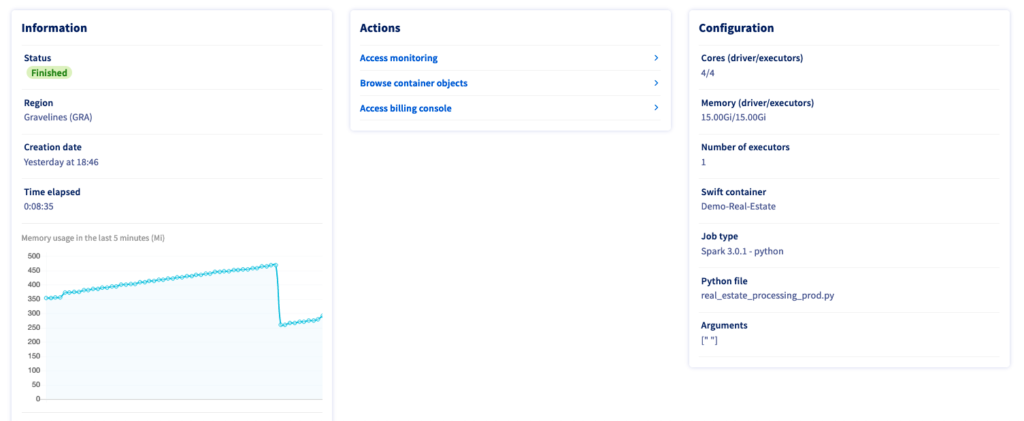

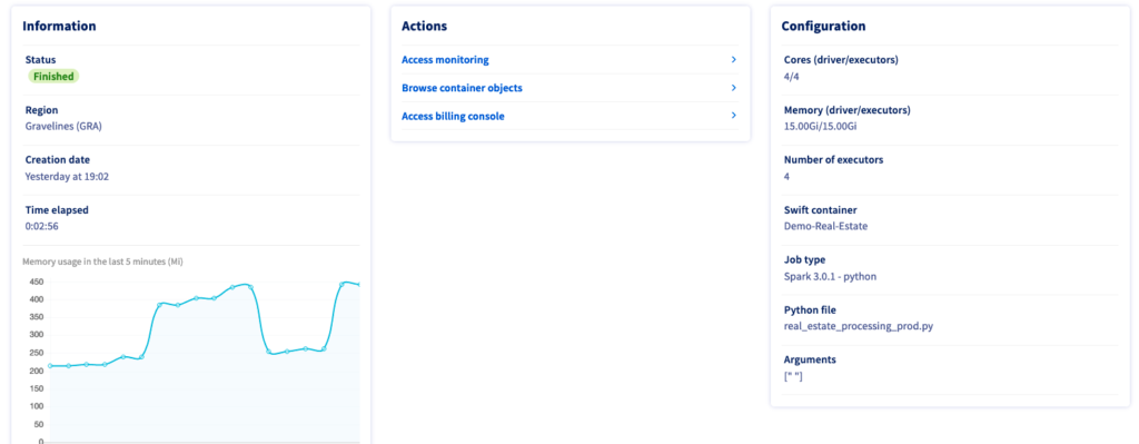

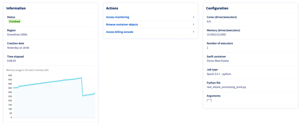

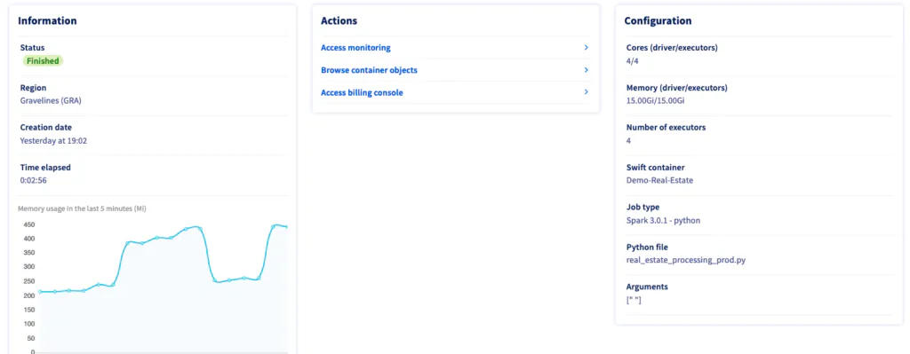

Before we start training a model, take a look at these two screenshots from OVHcloud's data processing UI to erase any doubt you have about the power of distributed computing:
In the first picture, you see the time taken for this job when launching only 1 executor- 8:35 minutes. This duration is reduced to only 2:56 minutes when launching the same job (same code etc…) on 4 executors: almost 3 times faster. And since you pay-as-you go, this will only cost you ~33% more in that case for the same operation done 3 times faster- without any modification to your code, only one argument in the CLI call. Let us now use this data to train a model.

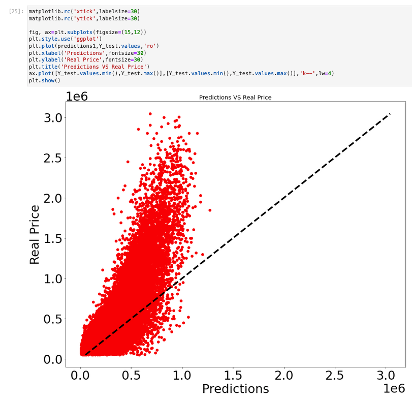

  • It reads the clean data from the folder where it has been synchronized from the S3 bucket and plots a few figures.

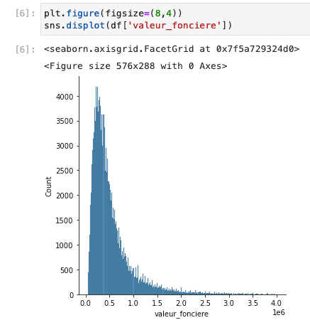

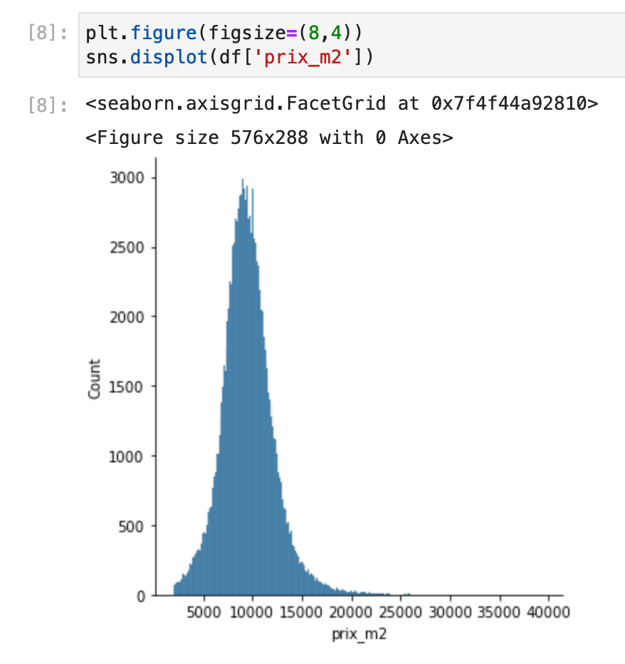

  • In these two plots, you can see that the most represented price range is between 400 and 500k€, and that the price per m2 is approximatively a gaussian curve centered on ~10k€. If you know Paris' real estate market, this shouldn't surprise you.

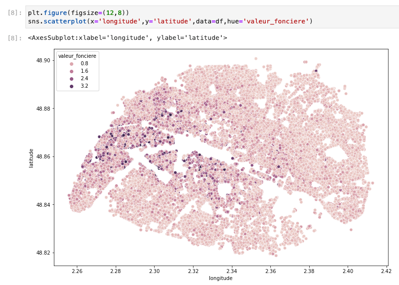

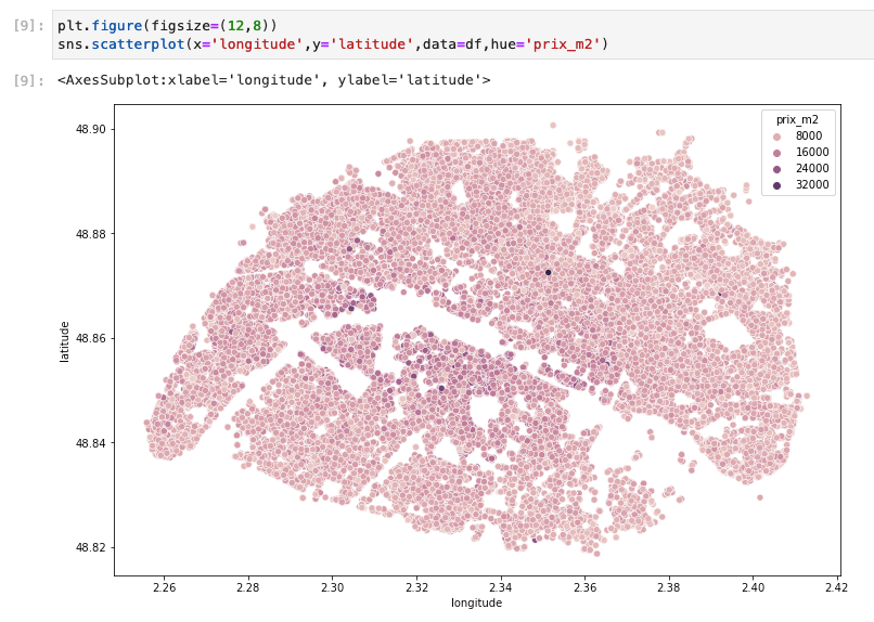

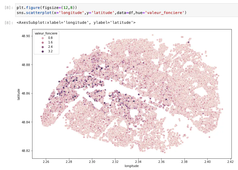

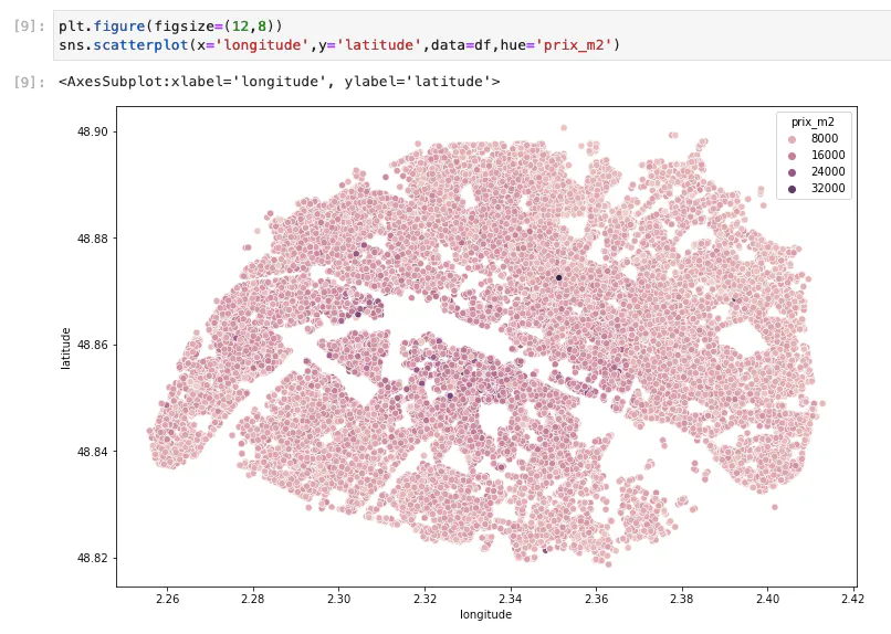

  • The next two plots show you the geographical repartition of the prices - absolute and per m2. They tell us an interesting story: if you look at the absolute prices, you can see that the West of Paris looks more expensive than the East. However, the price per m2 shows that for en equal surface, it is the center of Paris that is more expensive. That means that the center of Paris is relatively more expensive but has smaller flats to offer, so probably less families there!

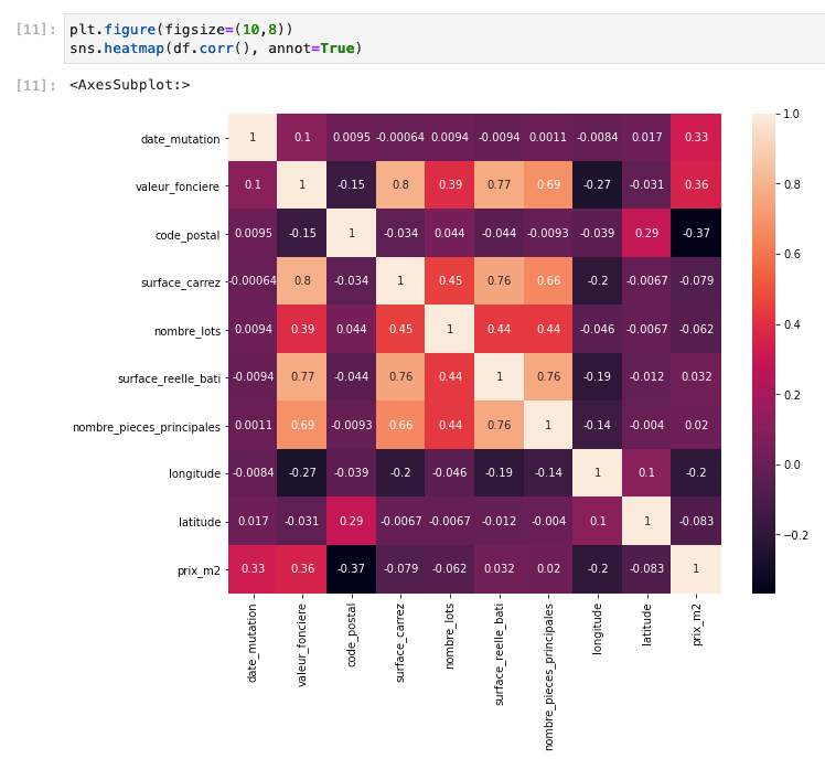

  • Finally, a last visualization plot shows you a correlation table of all numerical values contained in the data. Here are a few noteworthy facts:As expected, there is a very high correlation between the absolute price and the surface of a flat. This is common sense for whoever has tried to buy a flat in a city.There is a positive correlation between the price per m2 and the date of the transaction: again this is not a surprise as Paris' real estate steadily increases in value over the years.There is however only a very slightly negative correlation between the surface of a flat and its price per m2. This means that the bigger a flat is, the lesser its surface is taken into account in the price. However, this negative correlation is very small so it doesn't have that much effect.

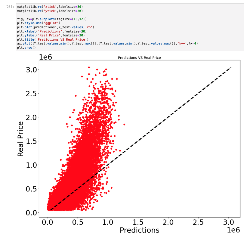

  • Once this is done, we create a neural network and finally train a model on a subset of our data! After this first model has been trained, we test it on the remainder of the data. In the next plot, you can see a mapping between the prices predicted by this model and the actual prices. As you can see, our model fares quite poorly and severely undervalues flats most flats.
Use the models built in this tutorial at your own risk...

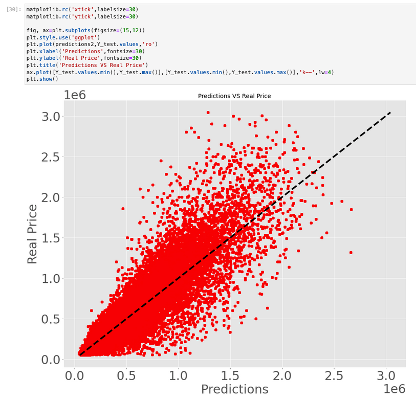

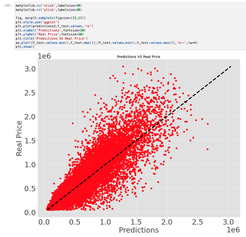

  • After this disappointing result, we create a new neural network with more neurons per layer and train it again. The following plot shows its result on our testing set. While it remains quite unprecise and still slightly undervalues flats in average, the results are much better than with the previous model.
  • Before stopping the notebook, we save both models to a local directory that will be synchronized to our transactions-ecoex-model S3 bucket.
So, what can we conclude from all of this? First, even if the second model is obviously better than the first, it is still very noisy: while not far from correct on average, there is still a huge variance. Where does this variance come from?

In this article, I tried to give you a glimpse at the tools that Data Scientists commonly use to manipulate data and train models at scale, in the Cloud or on their own infrastructure:
  • Object storage to store the raw and/or clean data;
  • Spark or any other distributed processing framework to clean the data - obviously alternatives exist for specific usecase, for example labelling tools to label images when the goal is to train an object detection in images model;
  • Notebooks running Machine-Learning frameworks such as Tensorflow, PyTorch, Scikit-Learn etc… to prototype and code algorithms.
