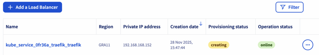

Install Traefik:
helm repo add traefik https://traefik.github.io/charts
helm repo update
helm install traefik traefik/traefik --namespace traefik --create-namespace --set service.type=LoadBalancer
This automatically triggers:
– the OpenStack CCM (used by OVHcloud)
– the creation of an OVHcloud Public Cloud Load Balancer
– exposure of Traefik through a public IP
After several seconds, the Load Balancer will be active.

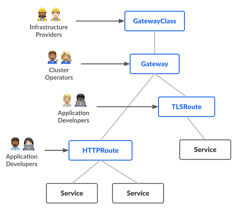

Gateway API: A modern, flexible networking model
The Gateway API is the next-generation Kubernetes networking specification. It introduces clearer roles and more flexible architectures.
Gateway API splits responsibilities across:
GatewayClass: defines the type of gateway and which controller manages it
Gateway: the actual entry point (e.g., a Load Balancer)
Routes: routing rules, protocol-specific (HTTPRoute, TLSRoute, GRPCRoute, TCPRoute…)
